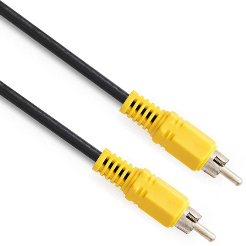

Posted by: mactjaap on 2023-03-26 08:20:12
I used this kind of cable.
