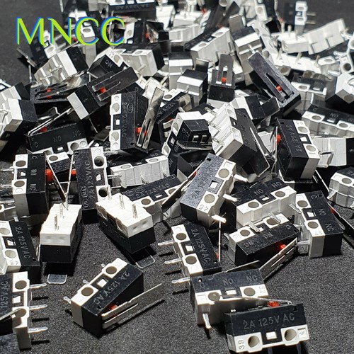

Old thread I know but where did you source the microswitch? I think one of mine is broken... They're both supposed to have lever arms on them right?
Posted by: pocketscience on 2023-05-08 14:37:59
Nothing special about the switch - I got mine from a local eBay seller.. He has measurements on the page so you should be able to find something to fit.
