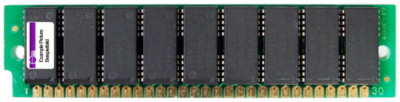

Thank you. I truly appreciate the help as I have no formal training in any of this. I actually just ordered this RAM, hoping to harvest the chips from the stick:
Please use the technical table below to carefully check whether the memory modules are suitable for the planned application. Please also note the specified module height - this can be important in devices with limited space. Please, check carefully whether the memory modules are suitable for the...
