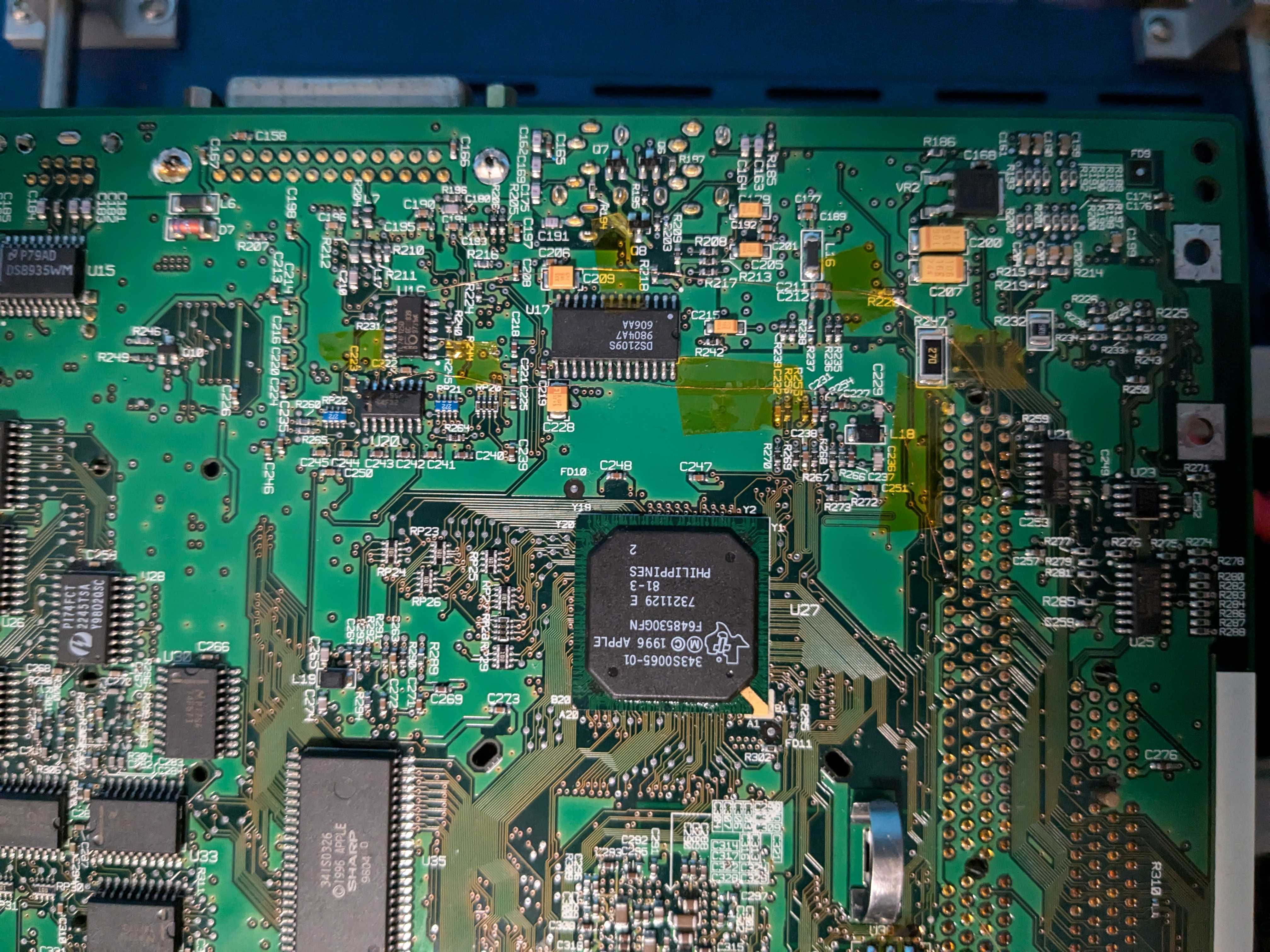

Now that I'm home, and I already have my Performa 6400 logic board out, I got curious myself.
On the Gazelle schematic, there is actually a connection for PCI_SLOT3_INT on A11.
On Alchemy, I can confirm it is a direct connection to pin 117 on O'Hare, as well as pin 136 on the cache connector (PCI_SLOT3_INT travels there too, for some reason).
Right, so, one of three signals, with GNT and REQ left to figure out.
Well, there's a reserved pin on side B, B10, which is near PCI_SLOT_REQ on B18 and and PCI_SLOT_REQ2 on B14.
Steps of four, so I checked continuity from B10 to pin 13 of U23 (74F32 on Alchemy, which is U20 on Gazelle):
Yes, there is a connection from pin 13, the REQ signal on 74F32, to B10!
So that's wired up, leaving just MOD_SLOT3_GNT, which should be on pin 11 of U23.
Well, on side A, near MOD_SLOT2_GNT on A14 and MOD_SLOT1_GNT on A17, there's another reserved pin on A19.
Sure enough, continuity to pin 11 of U23, which should be MOD_SLOT3_GNT on Alchemy!
So, in short, the PCI slot on the Performa 6400 and 5400 boards, is actually capable of taking a three PCI riser card, if wired up correctly.
I think that should bring the mythical Slot C to reality 🙂

So glad you're opening up a new front for this campaign. With you working your way up to the Logic Board slot from the schematic and me digging my way down to it from the Riser I'm thinking we might make good progress?
@trag any chance you could jump in again with your take on Apple's mangling or the PCI Spec?
