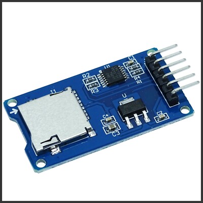

Posted by: dochilli on 2022-06-09 01:06:44 Removing the pull up resistor did not solve my problems with some SD-cards. I think that the spark shifter board could be the problem. I will try another board with some cables as connection to the tashtwenty.

I think that the spark shifter board could be the problem. I really don't know how to account for all the trouble that these things have been causing. I developed the firmware using one of the SparkFun boards and it worked fine for quite some time, and worked fine with my first build of my PCB as well, then it suddenly stopped, and then neither it nor any of the ones I bought since then have worked. Something something solar flares? Adafruit's board has been much more dependable, thankfully. |
