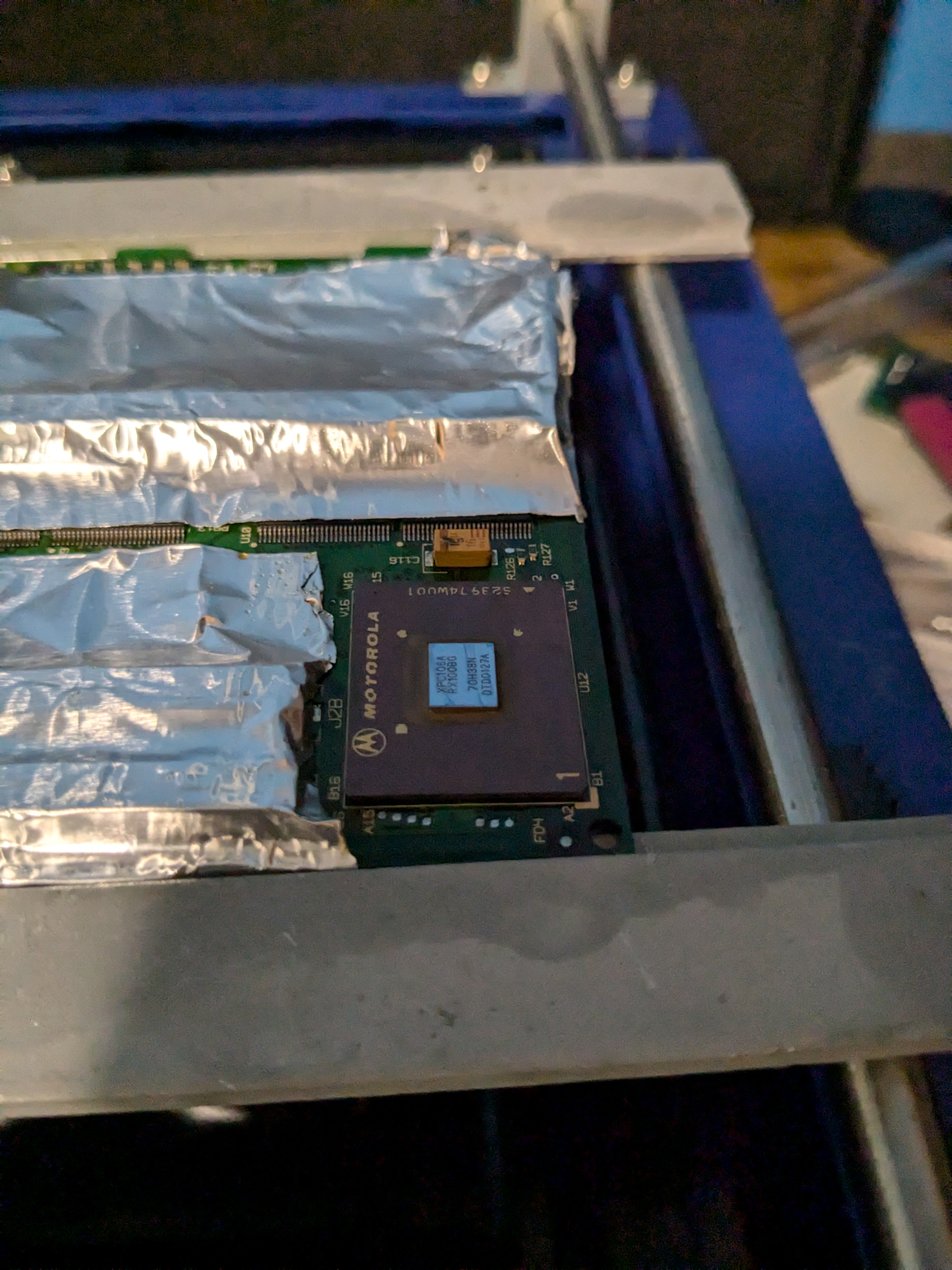

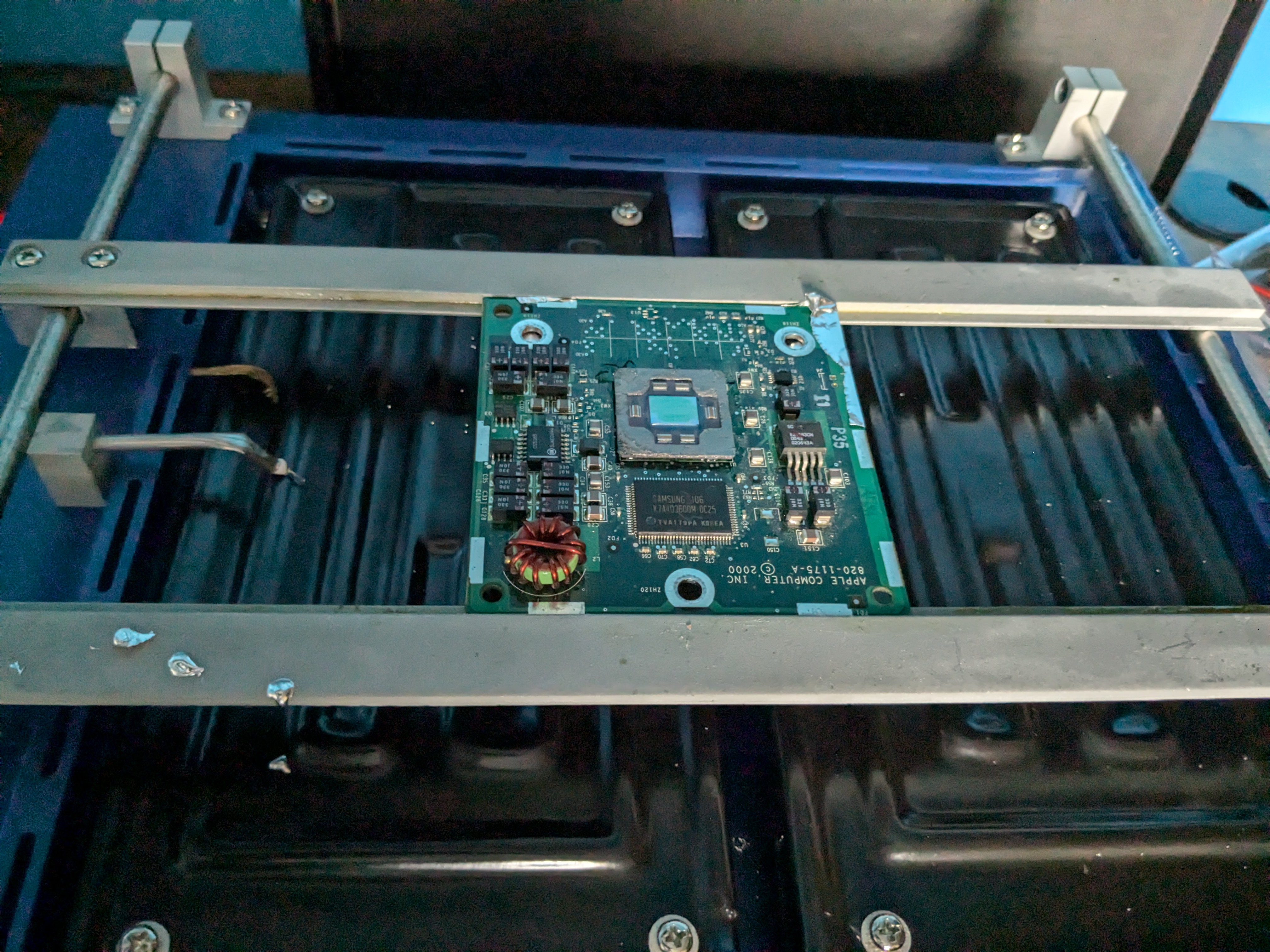

    | Posted by: LightBulbFun on 2024-07-30 09:42:05
Crazy to think I've been going on and off about finally getting the equipment to do my own BGA swaps since 2016, but this weekend I finally got a PCB preheater, and went for it.
Happy to report, this (badly vinegar syndromed) Japanese Pismo is now a G4 🙂
View attachment 76379View attachment 76378View attachment 76377View attachment 76376View attachment 76375
View attachment 76379View attachment 76378View attachment 76377View attachment 76376View attachment 76375 Nicely done! Once you get over the initial hurdle BGA rework gets fairly easy quickly, before you know it you be swapping CPU's on everything just because you can!

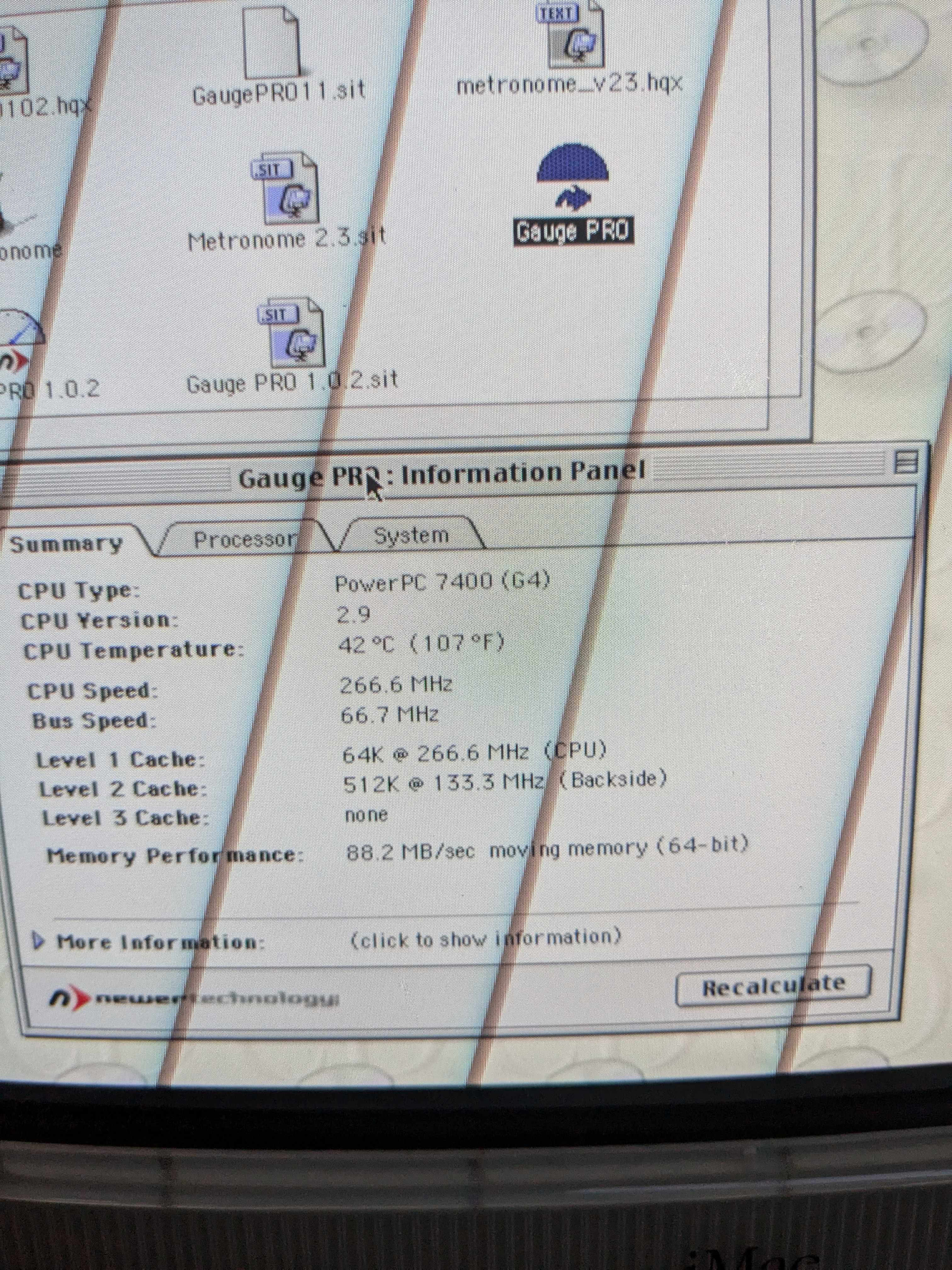

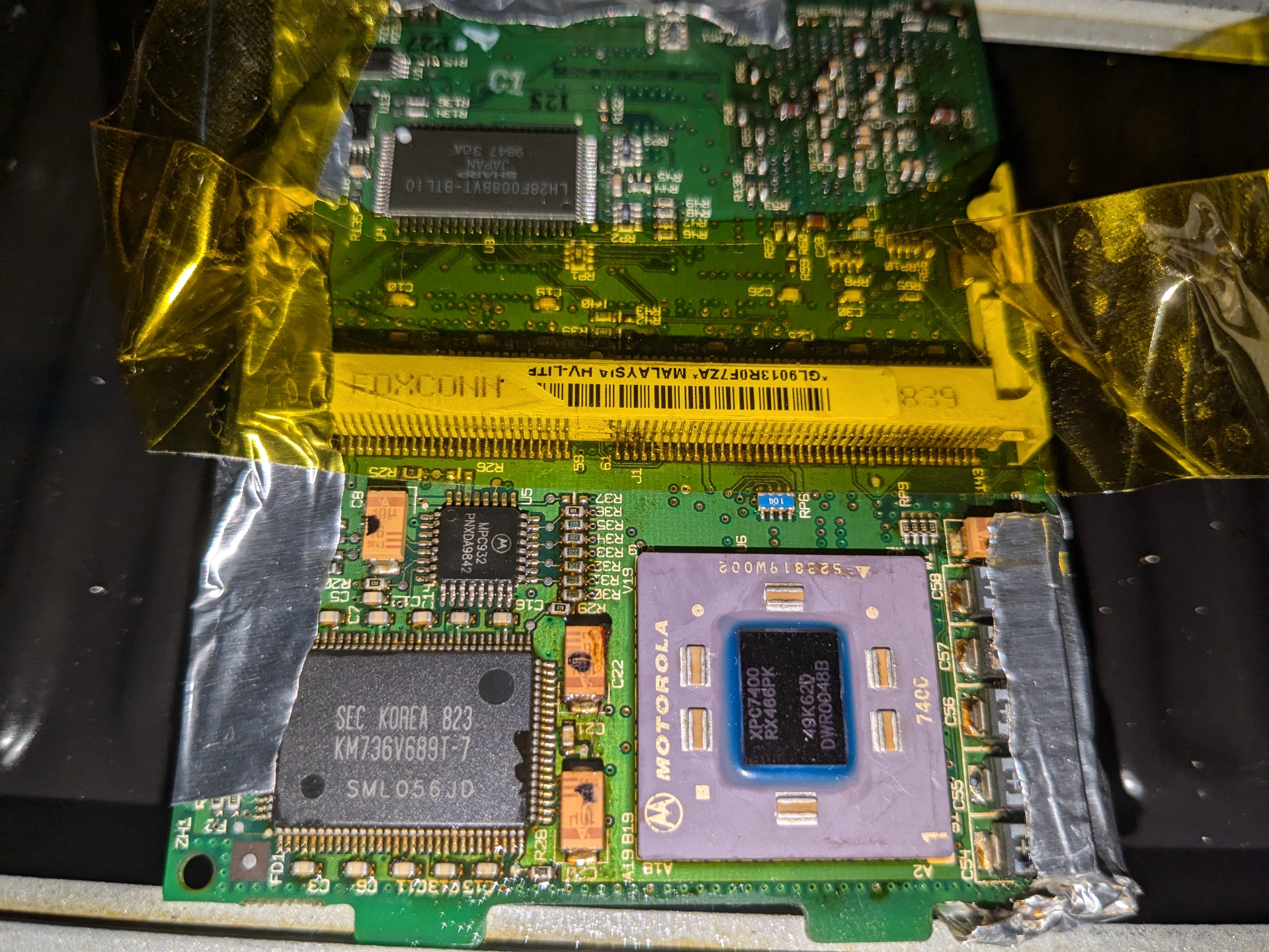

| Posted by: Daniël on 2024-08-14 12:53:44 I'm now working towards my own G4 Trayloader card, but I want to go the full mile, so alongside a G4 swap and potentially a cache upgrade, I want to swap the MPC/XPC106 "Grackle" bus controller for a 100MHz part. I figured out the PLL setting for 100MHz, and with the new Atten hot air station in, I decided to install the first chip on the card with a 100MHz XPC106 that I bought from Utsource:
With some PC100 or PC133 RAM, this should add a nice bit of memory bandwidth if all things go well 🙂 | Posted by: Daniël on 2024-08-18 12:09:53 Well, there's good news and bad news. The good news is that I managed to extract an XPC7400 from a donor PowerMac G4 CPU card, reballed it, and installed it on the card, which works!
Not pictured is changing the resistors for the vCore, I removed the singular resistor and changed them for a 10K + 27K pair, which comes down to about 7.3K (in parallel).
@dosdude1 shows this in his video, he mentions 10K + 28K, which is about 7.2K, though I figure the 0.1K difference won't change the voltage too much out of the 2.0V to 2.1V ballpark (nominal voltage according to Motorola is 1.8V to 1.9V, but Apple ran them at 2.15V on these PMG4 CPU cards).
However, as seen in the following picture, the bus speed is still 66MHz:
I need to re-check my PLL mappings for the MPC106, to make sure my changes actually did set it to 100MHz and 83MHz (both settings resulted in no POST).

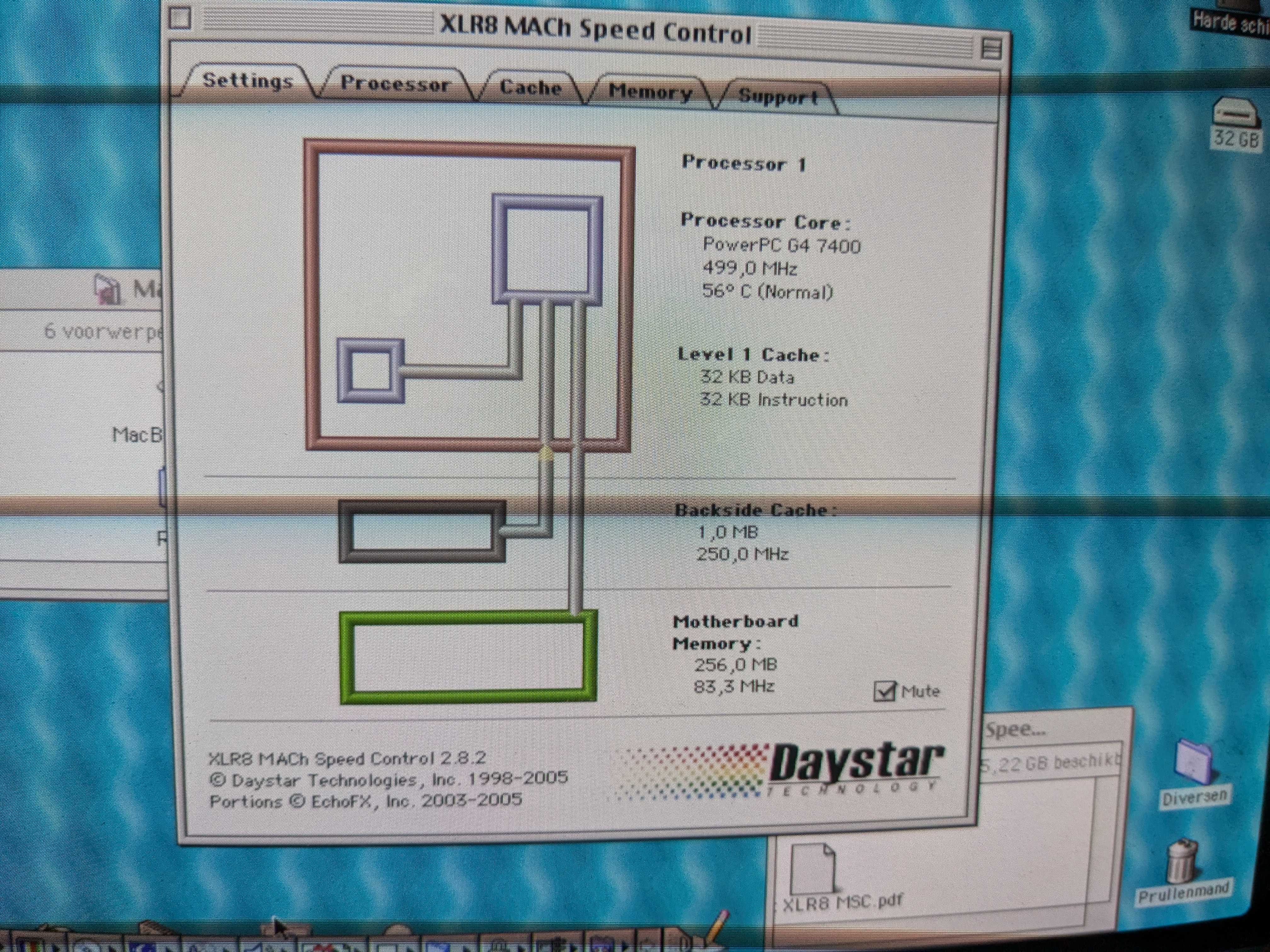

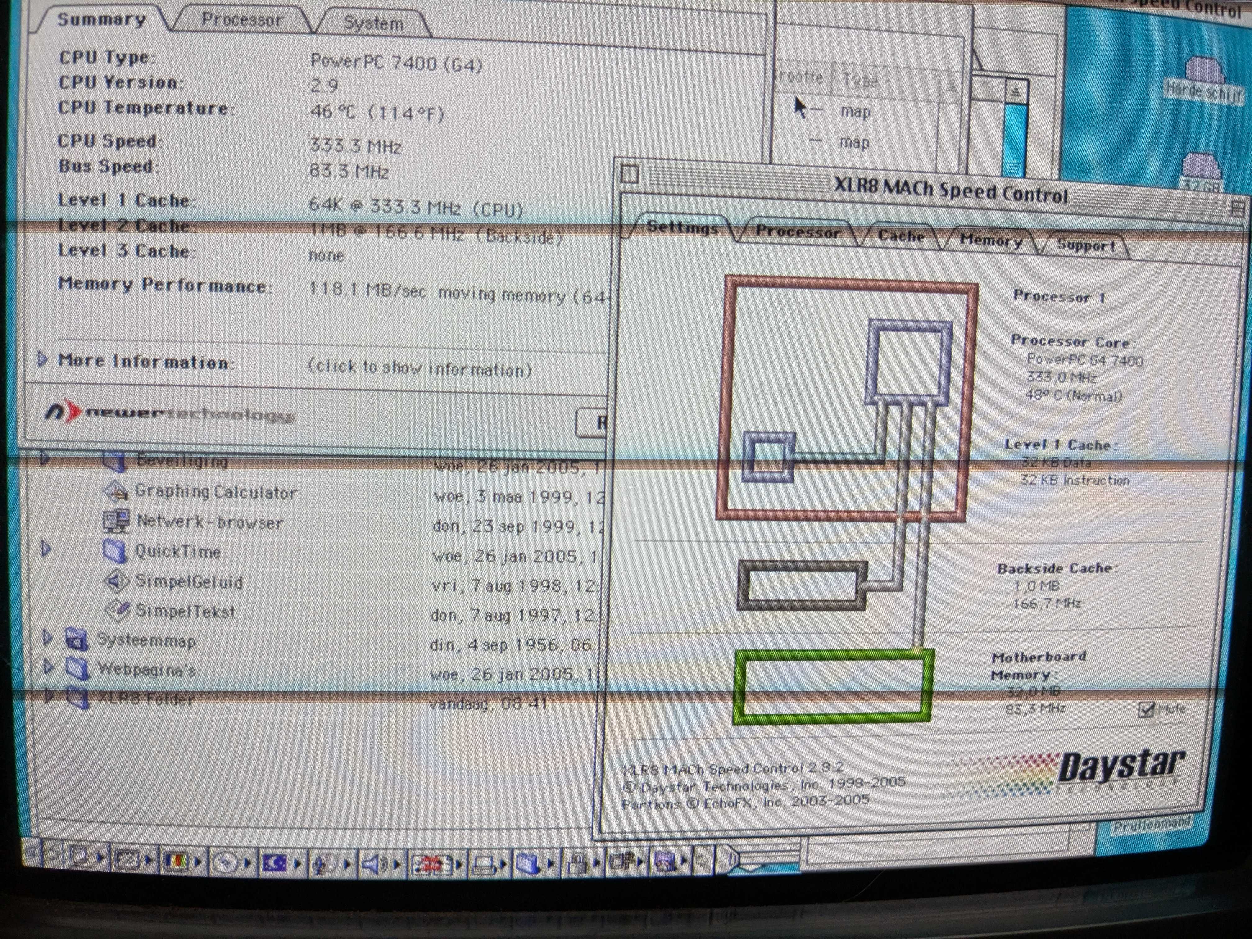

Frustrating though! 🙁 | Posted by: Daniël on 2024-09-05 15:44:31 Couple of days of bashing my head at this did actually get me results!
The eBay G4 card is actually an XLR8 MAChSpeed 400 G4, so that's pretty cool to know, even if it unfortunately doesn't work yet.
Now, I went in circles trying to figure out the cache SPD EEPROM out.
Had a few false starts, but eventually my own cache upgraded card started working, but I couldn't get it to report 1MB of cache in Gauge Pro.
The SPD EEPROM from the XLR8 did differ slightly, and they're both factory 233MHz G3 cards, so that did indicate something was different.
However, I got a sneaking suspicion it needed the MAChSpeed Control Panel installed to get the full cache to work.
Well, yes, that was the case!
Now, I know that @dosdude1 had tried editing the SPD EEPROM on his 1MB cache upgraded G4 Trayloader card, but couldn't get it to work.
He ended up using a Lombard SPD EEPROM dump instead, but that ran the cache at 5:2 at 400MHz CPU clock, and seemingly wouldn't let the system operate at higher CPU clocks.
So, with this software enabling the full cache instead of the SPD EEPROM doing the heavy lifting, would it be possible?
You do get some manual control over cache speed, so there should be more flexibility...
The answer is yes, this 466MHz XPC7400 will run at 500MHz, with the cache 2:1 at 250MHz, its rated speed.
I still hope to find out how to get the bus speed up to 100MHz if possible, as my attempts after soldering on a legitimate XPC106ARX100BG so far have failed to push it beyond 83MHz (still a nice bump though).
The XLR8 card has some cruddy solder joints on the cache chips that I can't seem to clear up with reflowing, so I might need to pull them entirely, clean the pads and resolder them.
