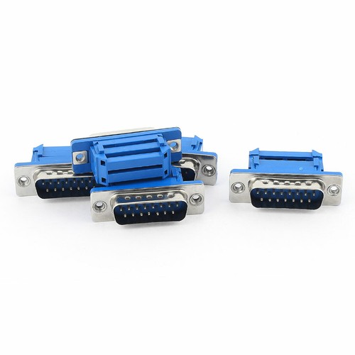

Any brilliant suggestions? Nope, but I wonder if these would help in any way?
Find many great new & used options and get the best deals for 5pcs D-SUB DB15 15 Pin Male IDC Type Crimp Connector for Flat Ribbon Cable at the best online prices at eBay! Free delivery for many products.
www.ebay.co.uk
They just fit into the recessed Mac II series cards.

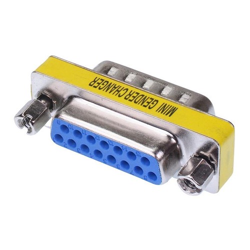

Another option is one of these as a mini extender - I have to do this to make my AUI transceiver fit in my IIx
Find many great new & used options and get the best deals for 15 Way D Sub Male to Female Adapter Connector at the best online prices at eBay! Free delivery for many products.
www.ebay.co.uk
Ignore that they call it a gender changer, it is just a stubby extension. | Posted by: bigmessowires on 2023-10-19 09:29:19 A dongle with cable is a decent idea, and it should solve the fit problem. Although I'd hoped to make this a one-piece adapter like other Mac-to-VGA adapters: just a simple brick that plugs straight in to the Mac.

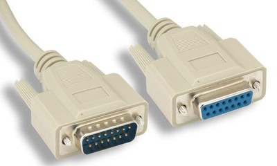

I like the idea of the gender changer mini-extender, because it's optional. You could use one if the computer needs it, or omit it otherwise. Another similar possibility would be a DB-15 extension cable like this one:
DA-15 Extension Cable 6ft 6 Ft DB-15 Low Density Extension Cable. DB-15 Female to DB-15 Male Cable. Used as a Joystick Extension on PC. Used as Video Extension on Mac's.
www.ebay.com
Although 6 feet is overkill and it only needs to be a few inches. But it would be the same idea: use this if you have problems with fit, omit it if you don't need it. | Posted by: bigmessowires on 2023-10-19 12:34:31 I probably confused everybody with my talk about "fake sync signals" yesterday. The point is that the VG900b appears to care about the rising edges of HSYNC, not the falling edges (or not only the falling edges).
