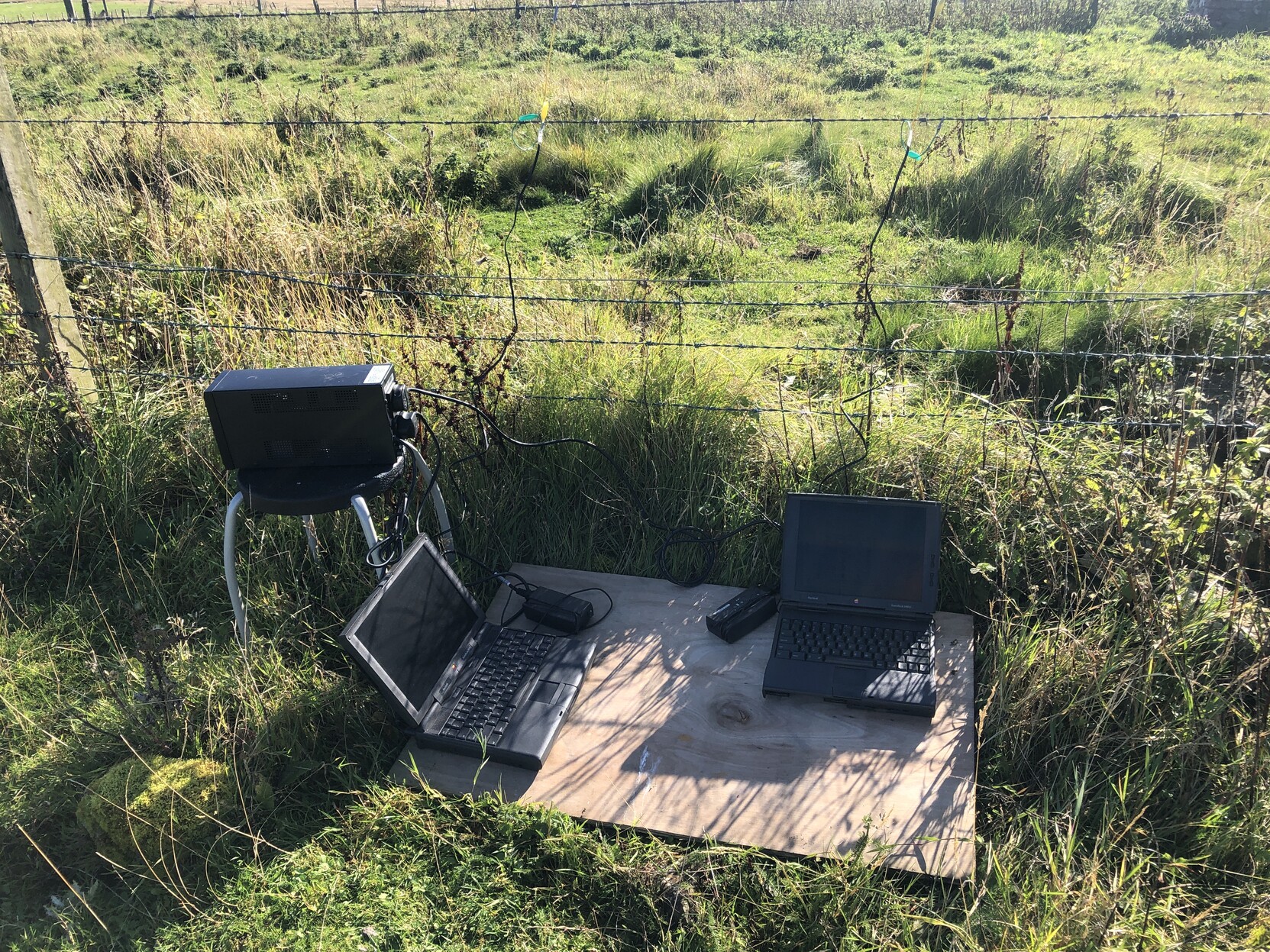

Posted by: NJRoadfan on 2026-07-20 18:33:01 PhoneNET is very robust. I've run it across like 30 feet of sketchy wire without a problem. Farallon states that you can have up to 4000ft runs with 22 gauge wire and up to 2000ft with typical 26 gauge phone cabling. People got it working across barbed wire fence!
Attached: 3 images Today I visited @mediaarchaeologylab@post.lurk.org's Barbed Wire Fence Telephone II installation to see if Localtalk over PhoneNET would work on it. I wanted to do this since @paulrickards@mastodon.social asked who'd be the first one to run LocalTalk over barbed wire a while...
bitbang.social
Attached: 1 image Rate my networking setup ๐ #LiveLaughLocalTalk #GlobalTalk #RetroComputing #FieldTalk
bitbang.social
