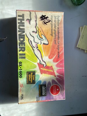

Posted by: eharmon on 2025-01-16 22:49:54 It’ll go for more than I want to pay, but a 1600 is up for sale if anyone wants one (bonus points for ripping the ROM).

Posted by: David Cook on 2025-01-18 19:59:28
There were two of these from the seller. I bought the first one (labeled #2 ironically) for $350. The seller messaged me today and said "Bro! Don't open that box. Resell it immediately for $810!" (not his actual words). I thought that was pretty cool of the seller.
Here is the unboxing. I could hear the depreciation as I broke the seal.
I just received a new-old-stock SuperMac Thunder II 1600 video card. It is still sealed in the original shrink wrap and the box's factory tape is intact. (Please note the "Free Software Offer!" sticker for later in this posting) I paid $350 for this. Ouch. The seller said they had another...
68kmla.org
The ROM is not socketed. What would you like me to use to rip the ROM? It's version 3.0.3. |

Posted by: zigzagjoe on 2025-01-18 20:50:14
68kmla.org
The ROM is not socketed. What would you like me to use to rip the ROM? It's version 3.0.3. Use the slot rom utility: https://www.gryphel.com/c/minivmac/extras/slotrom/
It'll save files next to where it runs. As the transformations needed (address/data bit swaps and inversions, if any) should hopefully be known from the lesser cards, there shouldn't be a need to desolder it from the card. |
