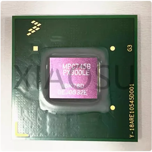

Now, I did try the 745BPX chips I have, but they didn't work, the PowerBook would power on but never POST/chime.
However, the chips also didn't get remotely warm, so I'm rather suspect of them actually working in the first place, as even if they aren't executing code, they should start to consume power and get at least slightly warm to the touch.
But to safely try a 740L, I really would want to lower the vCore, as even 2.42V is a bit much above its max rated 2.2V for comfort.

I'm also growing a bit worried about those AliExpress 745BPXs, they are a dark shade of green to the point of seeming black... but this one on AliExpress is much, much more obviously green, which makes me wonder if mine aren't cooked to hell and back...

Does the newer chip select 32-bit data bus mode in the same way as the 603? You might need to add or move a resistor on one of the mode pins. I would also check the other config pins, like 3.3v bus, etc.
Doesn't seem like they changed the behavior for selecting the 32-bit data bus mode, when reading both the 603ev's User Manual, and the 750L/740L's User Manual:
Start-Up: TLBISYNC is sampled at the negation of HRESET to select the 32-bit data bus mode; if TLBISYNC is negated at start-up, the 32-bit mode is disabled and the default 64-bit mode is selected.
The 750 selects 64-bit or 32-bit data bus mode at startup by sampling the state of the TLBISYNC signal at the negation of HRESET. If the TLBISYNC signal is negated at the negation of HRESET, 64-bit data mode is entered by the 750.
If TLBISYNC is asserted at the negation of HRESET, 32-bit data mode is entered.
As for the 3.3V bus mode, on the 745 the signal BVSEL pulled high sets it to either 2.5V or 3.3V, while pulling it low is an "invalid setting".
If I'm not mistaken, BVSEL is internally pulled up anyway.
You're talking about swapping from LT1507 to CS51413? Could it be that the CS51413 has too much ripple noise on its output, or perhaps just noise at a different frequency that affects the CPU operation? It seems unlikely that a ripple noise problem would be severe enough to completely stop two different CPUs from working, but stranger things have happened. Without checking with a scope, it's hard to say.
Yes, it was that swap I was referring to.
It probably will have to be something like that, knowing the 603e works just fine at the same voltage, coming out of the LT1507.
As mentioned, LBF did ask a PSU designing friend of his whether the frequency difference would matter, they said it probably wouldn't.
Then again, that person didn't know the full schematic and such, so there could be "obvious" problems to an expert that they simply couldn't know of.
I might want to shift focus back to the 745, knowing it won't need a buck regulator swap, but I need to verify mine actually work.
This might take a bit as I currently don't have hardware ready to go for that (I don't want to pull the 500MHz 740L out of my 6500). | Posted by: croissantking on 2024-11-14 03:51:10
This might take a bit as I currently don't have hardware ready to go for that (I don't want to pull the 500MHz 740L out of my 6500). You were going to try it out on a PowerBook 1400 series CPU card that you recently acquired, I think? | | < 10 > |
